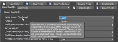

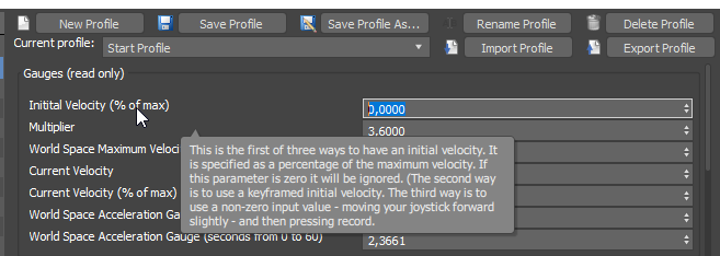

if you make sure to not press anything on record, does it still go forward? If so, it might have an initial velocity set in the configuration under gauges. It is bit confusing that it is stated under Gauges.

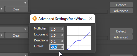

If I remember it correct the G29 uses the same axis between the brake and the throttle. So, I believe that the 0 value is actually at full brake and at idle it is 0.5 and 1.0 at full throttle which is a bit different to what many others do.
Try to set the offset to -0.5 in the advanced settings of the Gas Pedal Forw/Bakw input.

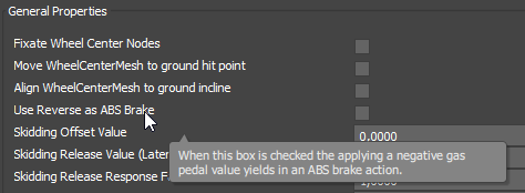

Also, if the car goes backward you have accidently assigned brake as forward and throttle to brake. You can switch the inputs by changing the multiplier to -1.0.
When using the Detect feature for Gas Pedal input setting it will set Foward as the first input and direction it detects and Backward (used as brake also) as the second. So, in your case it is most likely detecting brake for some reason as the first input and sets this to Forward. Again, you can invert this using the multiplier in the advanced settings.

Okay, we're getting somewhere, the 0.5 values are working, the car doesn't have any initial movement now, but I still don't get why would forward/backward assigned to the same pedal ?
