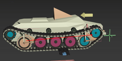

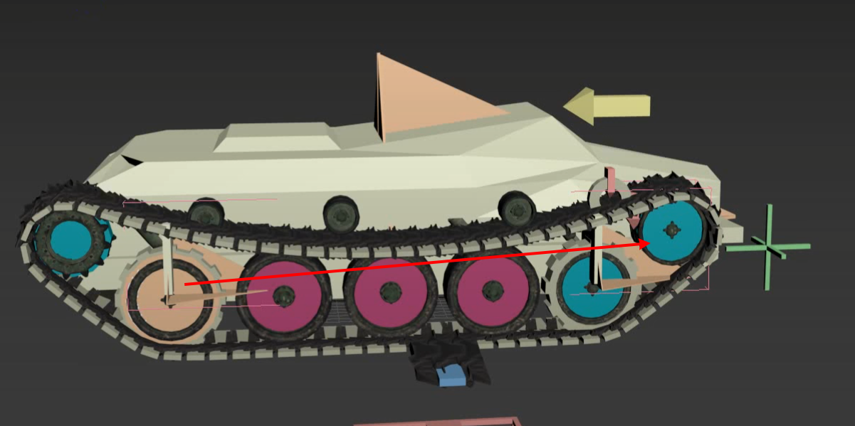

i somehow created a tank track with 4 wheels in strait line and it worked.
now i tried adding other wheels just as you can see in video and you will se tank tracks loose not moving with wheel.
check the video i uploaded.

tank tracks to loose help
Re: tank tracks to loose help
Hi a312er,
A couple of things
1. Place the drive wheel in one of the corners instead of the middle. The problem is that when the tracks does not hit the drive wheel it will not drive the track. Use CogWheel to dive the drive wheel from one of the Crawler's wheels.
2. Make the other wheels also turn to help move the track. Currently all other wheels in your rig is static, make sure to make them move also by using ExtraWheels or CogWheels.
