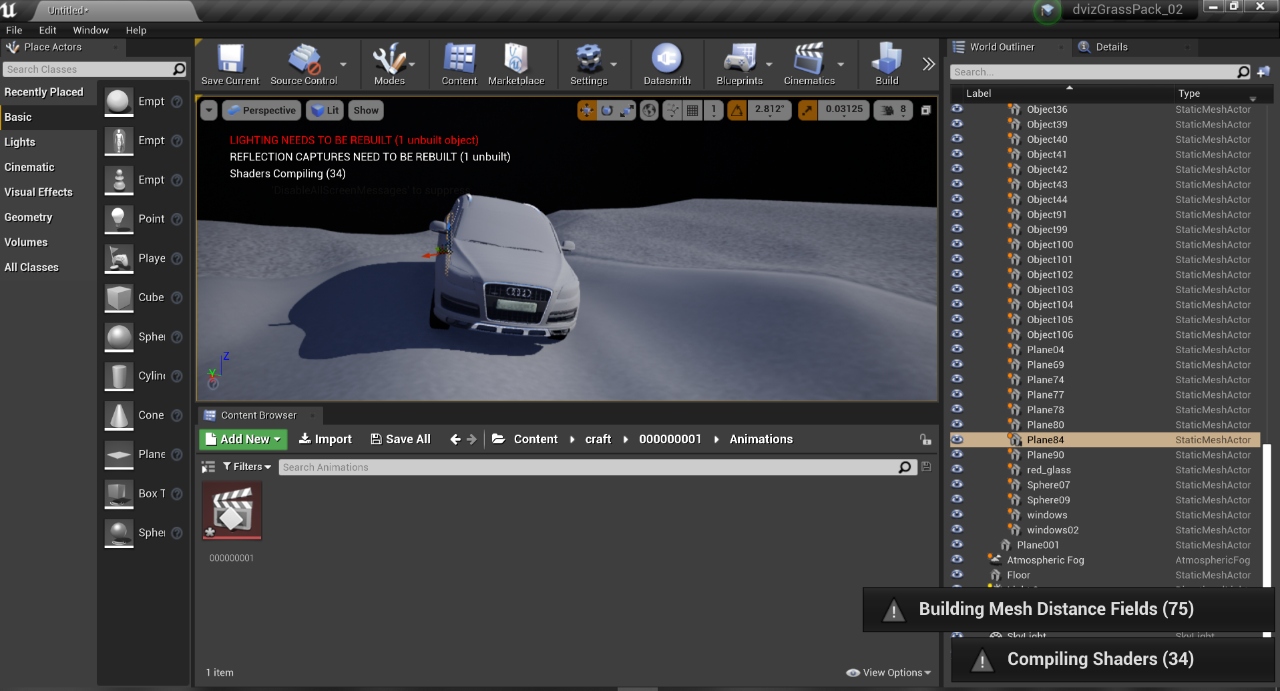

Hey everyone
Can anyone help and guid me through the process of importing an animated car to UE4 (Unreal Engine 4)?
Has anybody ever done it?
I did it as Alembic cache and FBX but since the objects are parented the movement doesen't transfer properly.
Thank you
Thank you

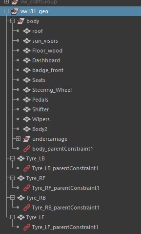

Hi, I am having similar problems where exporting animated mesh from maya to unreal doesn't work as expected.
I have constrained my model to the craft rig, baked the keys and exported both fbx and abc. The body of the car moves correctly, but the wheels act as if their pivot point has been changed.
I've checked all pivots, frozen and refrozen all transformations, matched all pivot points of the model to the craft rig, imported, referenced, tried many different export options, followed the directions in this post - but I can't get the wheels to "stay on"
If I export the craft rig with the model parented according to craft rig instructions - it plays correctly, (but then I have the craft proxy geo in the file. I haven't been able to successfully hide just the craft proxy geo, but will be trying that again soon.) if I bake and export constrained geo, it does not . . .anybody else have any ideas?

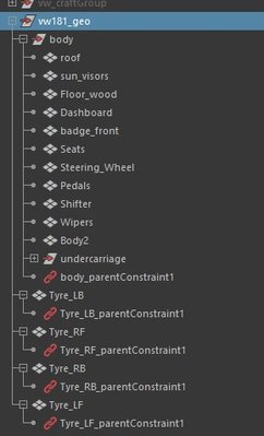

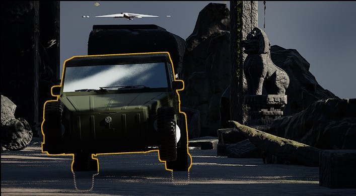

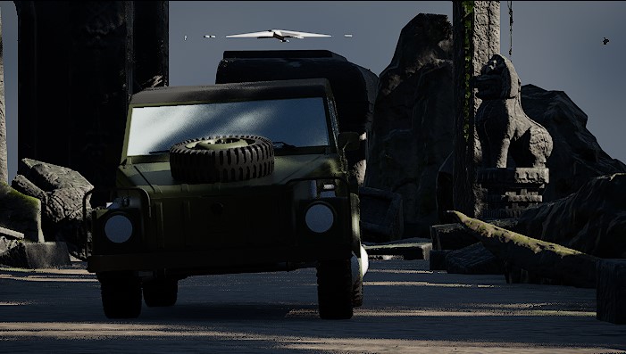

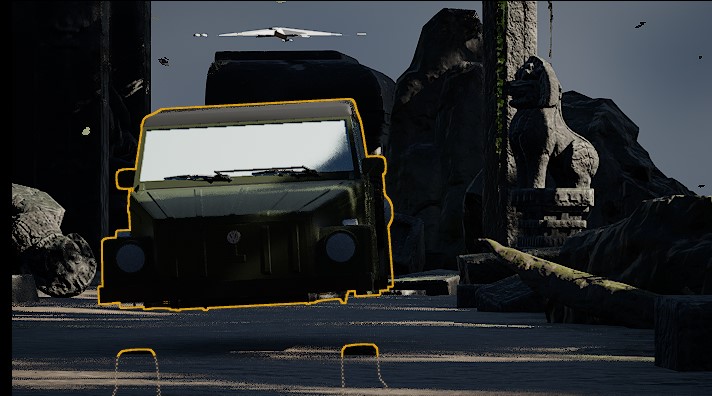

Hoping I can add some images for illustration of what my wheels are doing. . . first image shows wheels correct when scrubbing, but when playing or rendering, they rotate around a strange axis (other 2 images)

Make sure that all the meshes are directly constrained to the 4-Wheeler Extended wheel meshes.
Like this
- WheelMesh
- tyre
- rim
- bolts
- WheelMesh
- rim
- tyre
- bolts
- rim

Hey Patrick, thank you for your suggestions -
I'm using:
4wheeler free
Maya
I was only constraining the group node that had the meshes in it, before. After your suggestion, I constrained all of the individual meshes and got the same results as before.
I then combined the wheel geo, deleted history, matched the pivot point of the model geo to the pivot point on the craft rig geo, and froze transformations. I then constrained the "Tyre" geo to the craft tool geo and re-exported.
I am still getting the same results. The body geo group is constrained to the craft rig mesh and works just fine . . . I keep wondering if it's a setting in ue4 that I'm missing, as, when I import the results back to Maya, all subframes look as expected . . .
In ue4, the problem get's greater the farther the mesh moves from the origin, as if compounding somehow.
I have a few other things that I can think to try on my end . . . but welcome any and all other suggestions.

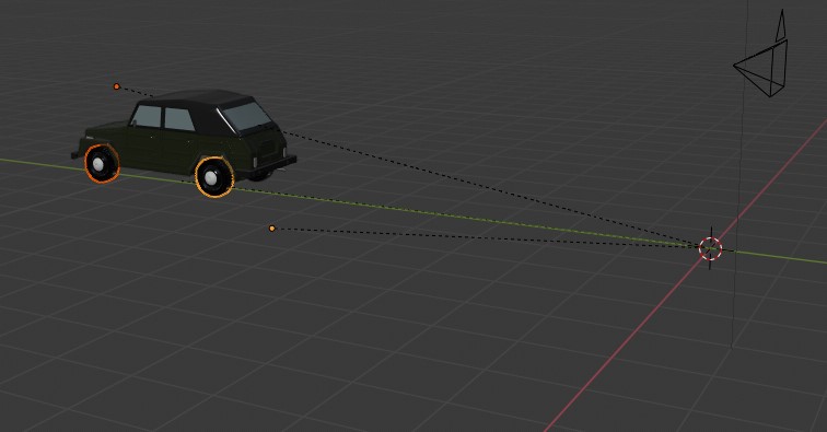

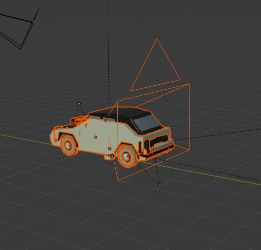

ok, if found something interesting, and i'm not sure how to rectify it - but there seems to be some transform that is getting left at the origin when I constrain things to the craft rig mesh, and export the constrained mesh.
since the export seemed to play fine in maya, i decided to drop it into blender to see what results i would get - it plays fine, but there is a representation of a transform that behaves differently between the 2 exports and seems to correlate with the results i get importing into ue4
maybe this is because i'm using the "free" version, I don't know - but you can see the orange dots and dotted lines travel with the craft rig car, but something get's left at the origin with the exported model only -

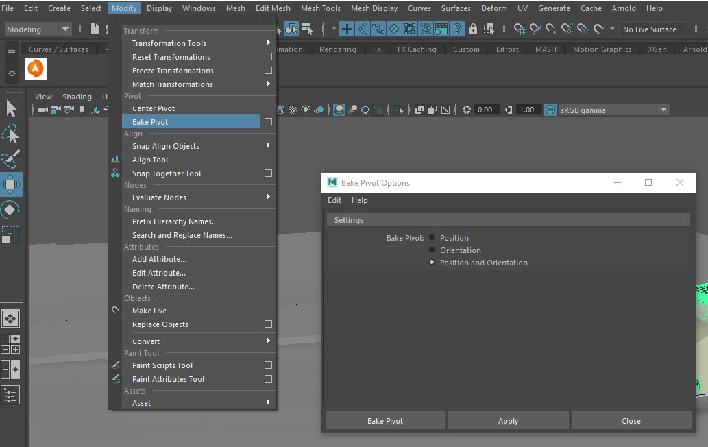

FIXED IT!
I long suspected that the issue with the wheels had something to do with pivot point, and it appears that was the case.
I don't know what's happening under the hood - but when I baked the pivot point, the issue was resolved. Whether a single geometry or in a group, I have imported the car geometry, then made sure the wheels pivot point matched the craft rig wheels pivot point. After that I have baked the pivot point on the model wheels.
DO NOT FREEZE TRANSFORMS AFTER THE BAKE.
When I baked the pivot, I got values in the trans X, Y and Z channels. When I froze these transforms, the issue re-appeared. If I left the values and constrained the model wheels to the craft rig, I was able to export an FBX which maintained correct transformations.
Hope hearing about this process helps others - it took me a long time to figure it out
Re: Use animated car in Unreal Engine 4
Nice to see that you solved it!boxpilot wrote: ↑Wed Oct 14, 2020 7:08 amFIXED IT!
Hope hearing about this process helps others - it took me a long time to figure it out!
