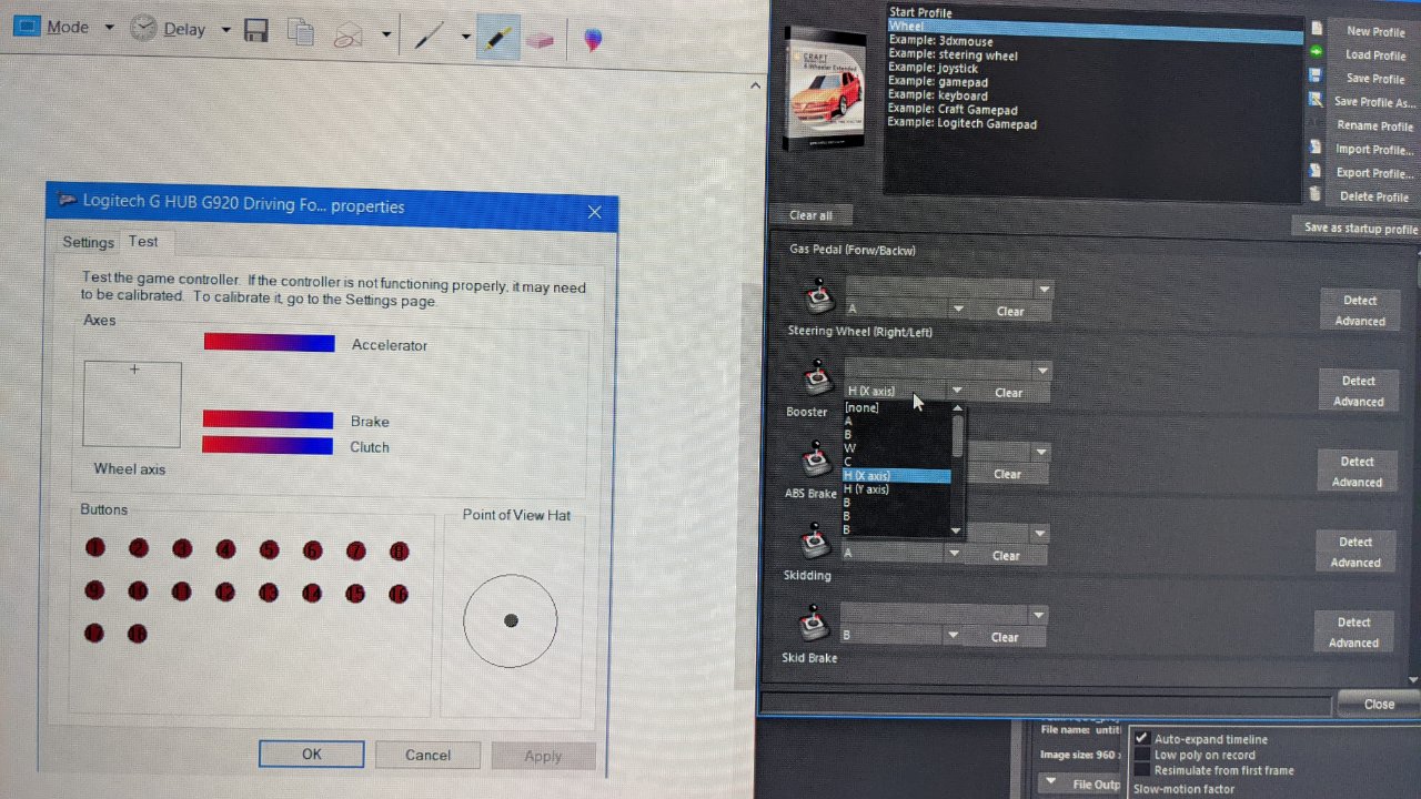

Does the steering wheel show in Game Controllers list:
and does it show movement when steering the steering wheel in it's properties?

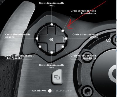

I wanted to do some verification. I have a joystick and 2 differents wheels. Joystick and old wheel sound to work but the G920 (the newest) sound to work only from the cross arrow.(see attachment) and it respond in game controller
Re: Getting Controller Working - Logitech G920
So the thing that is called "Wheel Axis" in the windows interface is the one that is shown first of the attachedments. So, non of them move if you turn the wheel? Well if it does not then we are not able to see this and thus not able to detect in Craft Director Studio.martin3dfx wrote: ↑Wed May 26, 2021 6:50 pmSorry for the delay,

The first picture (cross button) is the only axis that CDS recognized in Maya (H/Axis) but no other axis available. But in the window's controller Properties, the Wheel control the Wheel Axis like it should be.
It looks like there is an interference between the wheel and the cross button in CDS, and the cross button is the only one that CDS recognized. !!
