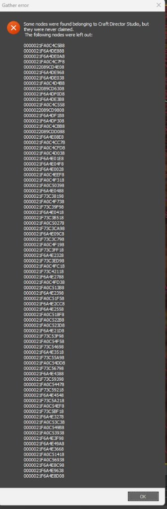

Hi,
After merging craft vehicles to another scene nothing happens. They don't show up in craft. After rebooting max and relaunching the scene I get error The following nodes were left out. See the image Thanks
I have the latest 3ds max 2023.3 and craft.

Also in 3ds max 2023 after merging craft never shows up. Max must be rebooted. In older max this never happened
Re: Cannot merge cars to another 3ds max scene
Post by Patrik Martin » Mon Jan 23, 2023 10:11 am
Hi, we will check on this. Usually it works to merge, then save then reopen. But sound like this is not functional at the moment.

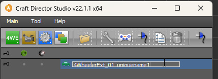

The problem:
Using auto rename upon merging a rig that has the same name as the scene will make it lose its connection to CDS.
Workaround:
1. Before merging change the name of the rig, with the same name, to something different via CDS treeview.
2. Save the scene
3. Open the scene again

Yeah. Temp fix for us. Unique name for each car. Then merging. Then saving and closing 3ds max. Then reopening the scene with a merged craft car.
