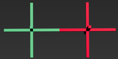

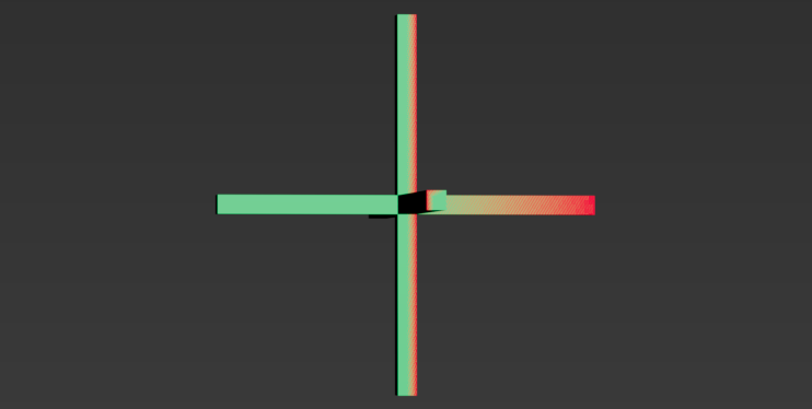

Nicely found with the DistanceRuler and linking it to the Input for the 4-wheeler. I was going to write about the DistanceRuler as an option, however, it is slighly more complicated to set up.

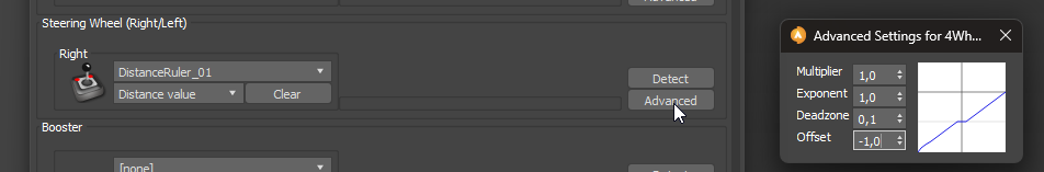

The issue is that the distant ruler only outputs positive numbers. So first when you connect you will notice that it will only can turn right. You need negative numbers to be able to do left turns. However, the good news is that there is a trick that can be used to solve this. If you go in to the Advanced setting for the input for the Steering Wheel you can create negative numbers by offsetting the input to have a negative number by default.
This means that;
This means that;

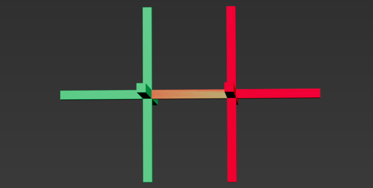

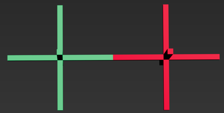

- When the nodes are exactly in the same place it will turn 100% to the left as the input is 0 which then outputs -1 to the steering (-1+0 = -1).
- When they are 1/2 overlapping the input is 1 and thus means 0 steering angle (-1+1 = 0).
- When the nodes are just touching each other the input will be 2 and thus will make the steering be 1, which is fully to the right (-1+2 = 1).
