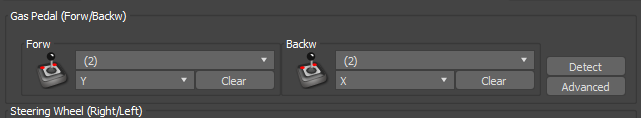

Here is how it should look once you load the profile. If not, then you might have used the wrong number for the devindex. If CDS does not find the device or input specified it will show an empty input.
How it should look:
Please note that you need for the input to be plugged in and active before you start the 3d program. If you plug in after the 3d program is started CDS will not be able to find the device.
