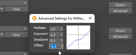

Re: Logitech G29 braking puts car in reverse mode
The logitech g29 is a bit odd as the idle value for the input is set at 0.5 and not 0. It's like the gas pedal is always pushed down with 50% instead of 0%.
This makes it have an input all the time unless this is regulated with the use of the offset feature that you are able to find under Advanced on the input. We could have made it easier by adding an indicator on what the value currently is and showed this in the graph.

You can have a look at this workaround to solve the problem.
viewtopic.php?f=3&t=4335&p=7818#p7818
