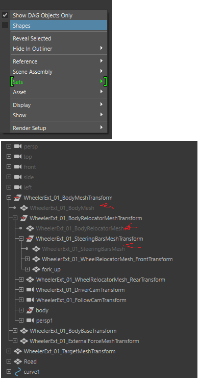

Hi, the trick I figured out is:
after all is done and the anim is baked you go to outliner and with right click enable shapes.
then delete the dummy shapes and export to UE4/5.
Important!!!!
All hires mashes have to be frozen before you parent it to the wheeler rig.
