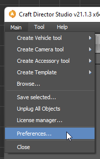

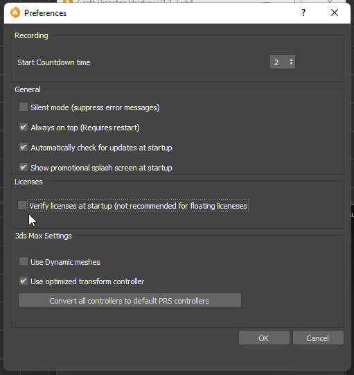

PLEASE NOTE!
Craft Director Studio has been updated with a function to prevent this from happening.
  1. *Go to Main -> Prefernces
  2. In the preferances window uncheck "Verify licenses on startup"
  3. Hit OK - Done
